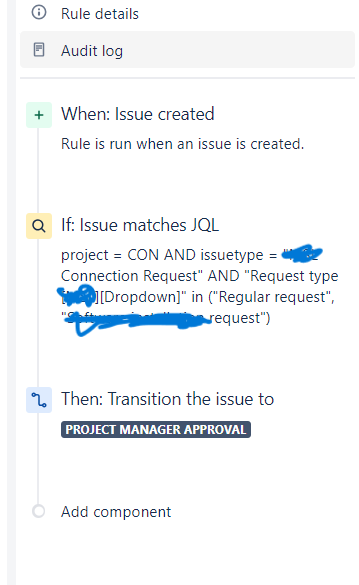

An automation looks like this:
 Automation #1  - WORKS
1. When issue created
2. JQL: Project = ,issuetype = , request type = (this or this)
3. The transition the issue to Project manager approval

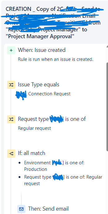

Automation#2:

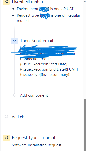

1. when issue transition from Connection Request Creation to Project Manager Approval
2. If: JQL - Project = , issue type = , Request type = this or this.
3. Is: all match
 Request type = 1
 Environment = 1
4. Then: Send email
5. Else- if: All match
Request type = 1
Environment = 2
6. Then: send email
7. Else -if: ETC.
Can you advice what can I fix in my automations so the project manager would receive an d email.

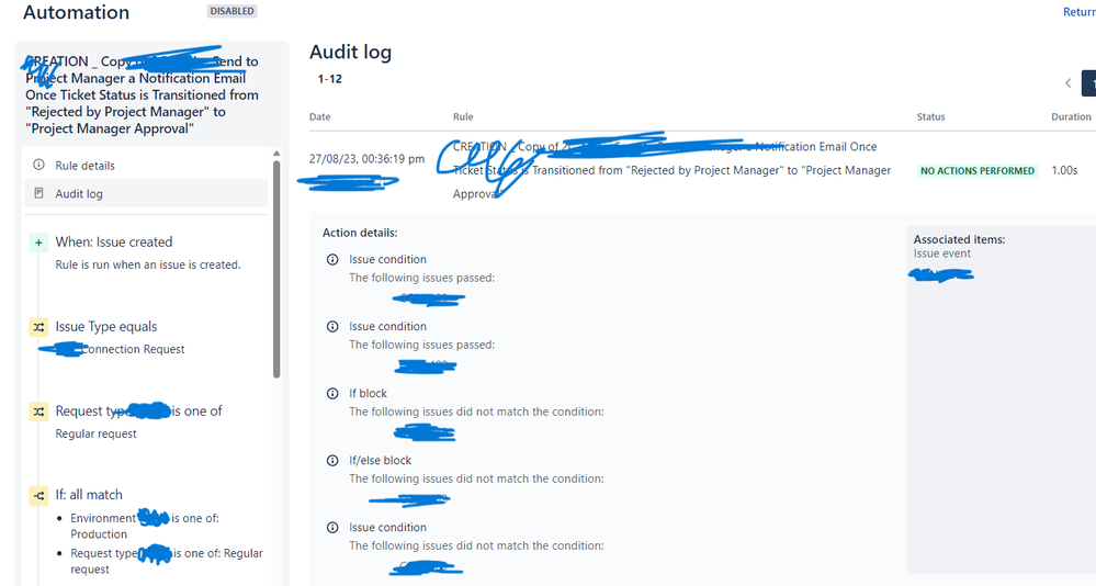

Thank you! Here are screenshots. One of the automations work and another one which is shown in two of the screenshots is showing  No actions performed.

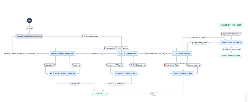

 There are also rules in the flow: for Emergency request, after creation - VP Aproval -  only when request type  is Emergency and same for Software &regular request types transitioning to PM approval (only requests types which are not Emergency one)

  • Your workflow
  • The automation log from the automation that is failing

Thank you for those screenshots. From the looks of it, the automation triggers correctly but the issue does not meet the criteria of the if statements. From what I can see, it looks like the environment might not be set correctly.
One way to troubleshoot is to take it one step at a time. Duplicate the automation and change the trigger to manual, then create a test issue and try to solve the automation problems with that issue.
Does it pass the first condition? Great, on to the next. Does it pass the if block? No, why not? What information am I asking and what am I missing? It can also help to write the value of certain check to the log so you can verify that what you think is being checked, is actually checked. For instance, I thought I was checking a reporters name, while the automation was checking the reporters ID.
