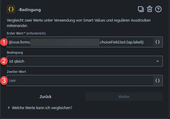

Dimitrios Kouroumichakis
March 13, 2025
Hi @Marc -Devoteam-
there are multiple values in the checkbox field, SAP, Qlikview, etc.... What would be the operation then?
Would this be correct here?
{{issue.forms.UUID.choiceField.last.Sap.label}}
If so, what would I have to put in points 2 & 3 see picture?
The aim is to create a ticket when box 1 is clicked (SAP). If 1 & 2 then two separate tickets because different departments.
Thank you in advance for your answers

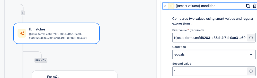

Marc -Devoteam-
March 13, 2025
Hi @Dimitrios Kouroumichakis
Use the https://developer.atlassian.com/cloud/forms/rest/api-group-forms-on-project/#api-project-projectidorkey-form-get  to get the UUID of the field SAP
  1. {{issue.forms.<UUID checkbox field>.Sap}}
  2. ist gleich
  3. value of the option SAP (seen int the API call as well)
Example:

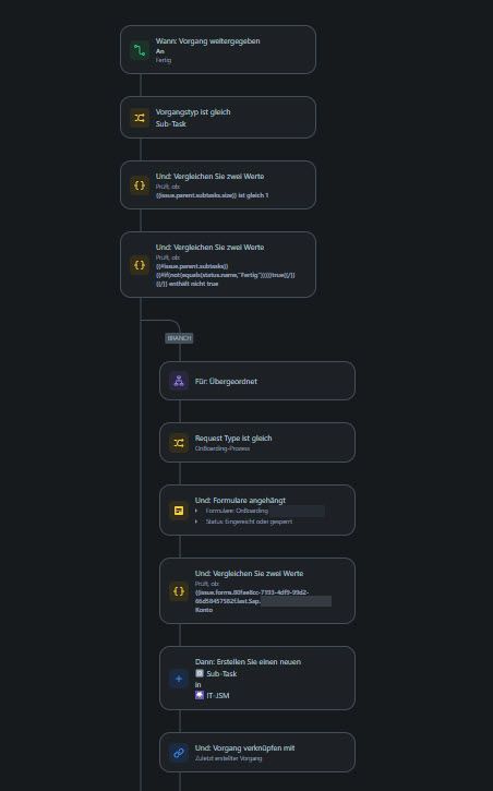

March 12, 2025
The Automation :)
