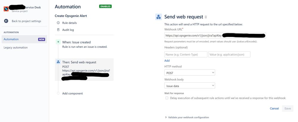

I just migrated our classic Service Desk project to the new Service Management project template, and now we're no longer getting Opsgenie alerts for new service desk issues that are created.
I've tried adding the automation rules back in, and even though they appear to be running correctly, no alerts are being added to Opsgenie.

Thank you, Hana.  I tried adding the webhook back in, and while the automation rule runs successfully, no alert is generated in Opsgenie.

is there an OpsGenie URL in the webhook? If so, are there issue created / updated events checked? Is the JQL in the webhook correct and corresponds to your new project?
Matthew Cook
January 11, 2021
Yes, there is.

The thing is I'm almost sure the request body is little bit different, when you use issue data in new automations (vs. OOB webhooks) and I suspect this is the problem (OpsGenie expects a little bit different data). But still I like the idea of using new automations and I would like to see it functional.

I was able to make it work, but I needed to use legacy automation rule or system webhook. When request is send using new automation rule, payload data are little bit different and even though the response code is 200, alert is not created.
How to configure it using webhook can be found here, in the section Configuration in Jira Service Management. I think it is more safe way then to use legacy automation rule (because I think these will be removed in the future).

I really appreciate all of your help with this.  I was able to get it working again using a webhook as well.  Thank you!
