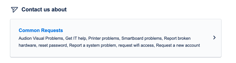

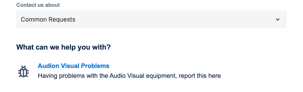

For an unknown reason the spelling of Audio has changed to Audion?
In the setting area it is correct as Audio, in the customer helpdesk it has changed to Audion?

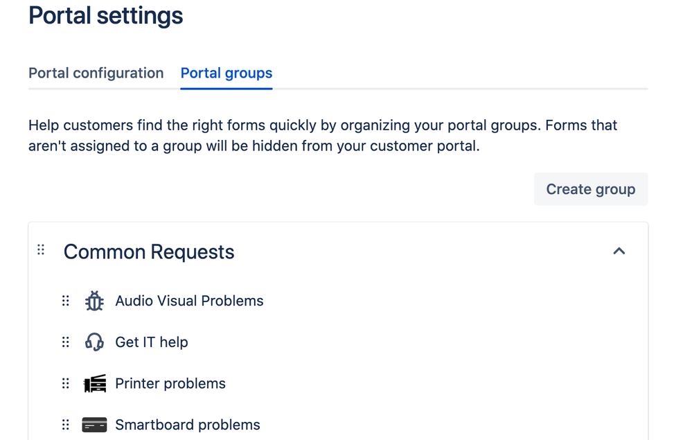

A few screenshots for you - the first is the configuration for the portal, with the correct spelling.  The other two are from the customer helpdesk showing how this displays.

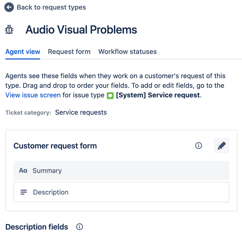

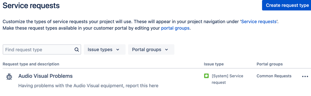

So I believe this is a misspelling in the Request type. If you are an admin go to project settings > Request types and see if this is the case and can be corrected there.

This is the cryptic problem, the screenshot of the common requests in the portal settings area and in the Request type shows the correct spelling...  when you set this and go back to the customer help desk the spelling changes.  It was never set as Audion and appeared during many weeks of testing.
See further screenshots

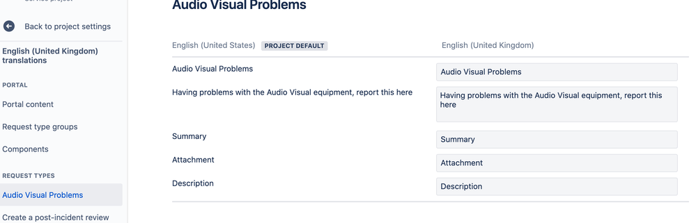

Stephen Mollison
May 18, 2022
Hi Jack,

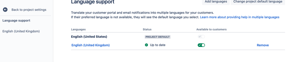

Just found the problem which stems from the translation section - as the default is English United States and I have set English United Kingdom it created a translation for Audio as Audion which filtered through from the Request Type to the customer helpdesk.
I was accessing the portal settings from the Request type pathway where the administrator can change the header title as you referred with no luck.
I found this by chance when I was looking how to set English United Kingdom as the default language when I spotted the error.
I have now corrected this and all is well.
Thank you for your time to help.
Screenshot 2022-05-18 at 11.01.11.pngSteve
