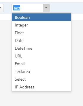

After a quick google, I have created a custom field but i cannot figure out how to assign this to an attribute:
These are the only ones available

Any chance you could point me to the right area to do this.
I have created a custom field from within the issues settings, where do I go to enable this within the insight attributes list like the picture above?
The custom field is selectable within the service desk but not there
