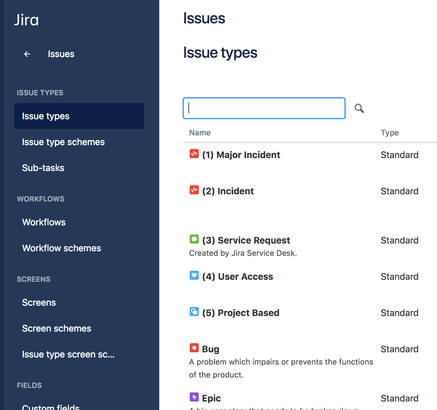

It's not possible to have such ordering using JQL, you would need an additional custom field with the weight of these requests with numeric values, for example, but it would add too much complexity to match which weight correspond to which issue type.
To simplify it and provide a solution to you, you can rename your issue types to start with a number, like this:
It will do the trick and not add any complexity to your project and users.
Keep us posted on your thoughts!
