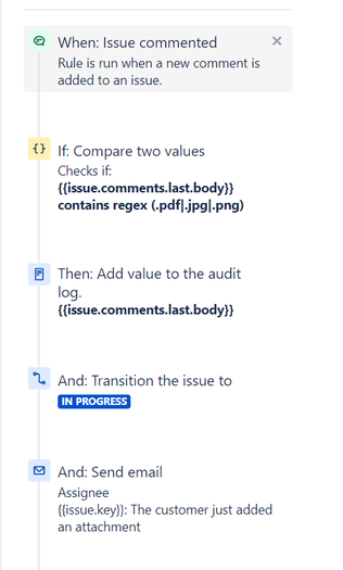

Attachments are placed on comments. So what you need to do is actually monitor the comments. If you run an automation and log the way an attachment appears, then you will get something like the following:
As you see, xlm/pdf/doc files etc are represented between square brackets, where as images are placed between "!" and have a different format. With that said, and after experimented for a while, the only solution/workaround I can propose is to play with regex. Since I'm not that familiar with it, with a simple OR regex, I got the result I wanted. However, it's not 100% accurate, since it searches for specific strings:
So you search for the last comment, if it contains any values like ".pdf", ".jpg", ".png". If it does, the it pass the if statement and proceeds with the rest of the tasks.
The problem is that a user can write for example on a sentence "Hey Dimitri, did you read that .pdf I've sent you?". If that's the case, then the rule will still run and transition the issue. To overcome that problem you could modify the regex and instead you could write (.pdf]|.jpg|.xlm]|.png) and so on and so forth. You just have to see (by using the log action) for every possible file extension, how this is represented within Jira.
Hope that helps!

Awesome solution! Thanks again! Have a great day.
