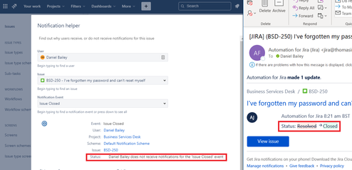

Hello. I've edited notifications so that none are sent for event 'Issue Closed', I confirmed
this was set correctly by using the notification helper, but emails are still being sent. Is there an extra step I'm missing?

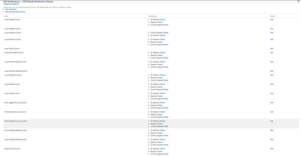

Can you share your notifications? It could be due to “Issue updated” “commented” “resolved” etc.
danielb
July 15, 2020
Thanks Jack - I subsequently deleted notifications for 'Issue Updated'. Do you see any other's I need to amend?
Dave LIAO
July 15, 2020
@danielb - also check "Issue Resolved"?
Once an issue is transitioned to a Status that's of a "Done" type, that can trigger a notification.
Like danielb likes this
Jack Brickey
July 15, 2020
agreed

danielb
July 16, 2020
Thanks @Jack Brickey & @Dave LIAO - switching off notifications for 'Issue Resolved' solved it for Agent notifications. We don't want to switch the same off for Users, so it means they will still get notified when the issue closes, not ideal but we can live with it.

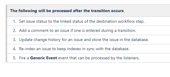

Don Masten
July 15, 2020
Also check your workflow post function. It may be set to fire a Generic Event and that will send emails based off the notification scheme.
Jack Brickey
July 15, 2020
true but the notifications are triggered by the GE so the notification event is controlled via Notifications.

@danielb - from your screenshot, it looks like your notification email is being triggered by "Issue Updated".
Hope this helps!
