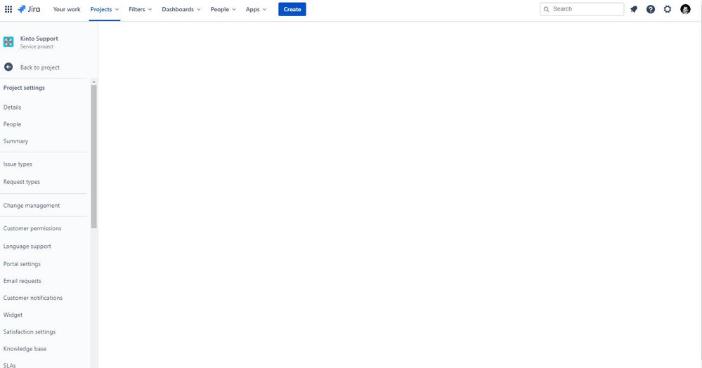

So I found an article in the Atlassian community from 2017 that provided a solution to stop internal customers from logging Support projects through the Create button in Jira, instead making them use the Portal to create issues. This works really well, but it has had a side effect:
In the specific JSM Portal I am building, I cannot see the Notifications for this specific project. I know it was caused by my other change as it gave me a generic warning when i made the change, but now that i have reverted it back, the Notification screen is still blank.
Any ideas?

@Phil Borrell - hi Phil!
Sounds like a coincidence. Locking down the "Create Issues" permission wouldn't prevent someone from seeing a specific admin screen.
Can you share a screenshot?
Phil Borrell
January 17, 2021
Thanks for the message @Dave Liao
I was also under the impression that 'Locking down the "Create Issues" permission wouldn't prevent someone from seeing a specific admin screen.'
Attached is a screenshot
This is a partial URL for that page: atlassian.net/plugins/servlet/project-config/KOS/notifications
Cheers,
Phil

Dave LIAO
January 18, 2021
@Phil Borrell - try clearing your cache and cookies and load that screen again? Try in an incognito window?
Can you get to the notifications section of other projects you administrate?
Phil Borrell
January 18, 2021
@Dave Liao thanks for the suggestion. I cleared my cache and used Chrome incognito, and i still get the same result.
I also cannot see the notification schemes in any other project, but i can see the Global notification scheme
Dave LIAO
January 19, 2021
@Phil Borrell - as a workaround, can you click "Summary" (in your project's settings), and see what Notification scheme is configured for your project? Try clicking into the scheme from there.
If that works (or not), it sounds like a bug you're experiencing where you can't get to the notifications scheme for your projects straightaway.
Phil Borrell
January 19, 2021
@Dave Liao I already thought of that, and unfortunately, I get the same result.
As I said I can see which scheme each project is using in the Global Notification Scheme, but if I click on the project from there, I get the same blank page.
Phil

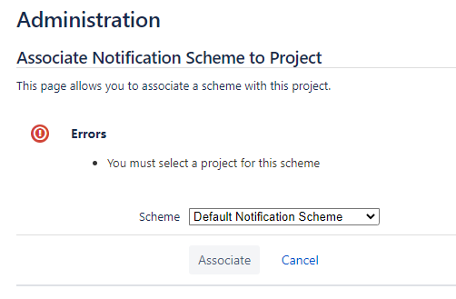

Nilsen_ Kim
November 2, 2021
Hi,
I tried this, but then when i choose an scheme i get an error. The project is currently in "none" scheme.
Dave LIAO
November 2, 2021
@Nilsen_ Kim - projects should have a notification scheme attached to them.
If you're OK with the default notification scheme, set that (via the screenshot you sent), and then you can see the notification scheme for your project.
If you try going to that URL again, you can set the scheme to None - then you won't be able to see any values on the Notification pane.
Nilsen_ Kim
November 2, 2021
Hey Dave,
The issue is that i can't choose the default notification scheme, or any other scheme, as i get the error message in the screenshot shown. The project was set to none by accident, and im now trying to correct this, however JIRA won't let me change back to a notification scheme.
Nilsen_ Kim
November 3, 2021
Weird enough this solved itself after a restart of my computer. Thanks for the help Dave.
