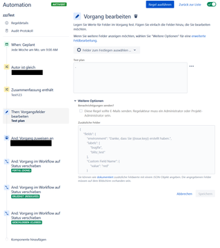

Hello,
we work with "Automation for Jira". That relieves us of a lot of work.
Since the automations close tickets themselves, we are currently receiving three notifications per ticket. there is a lot going on.
How can I reduce these messages to one or deactivate them in Jira?
The only important thing is to deactivate the Jira automations.
We also get a lot of emails through these automations, how can I change that?
Thanks in advance!

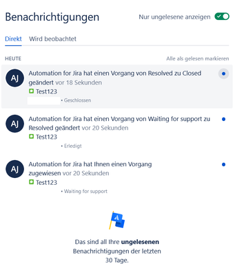

The problem I still have now concerns the screenshot.
Whenever automation is doing tasks, I get notifications in Jira itself. Is there a possibility that the messages won't appear at all?

@[deleted] Ah I understand now, you're referring to the in-built notifications within Jira. I don't believe there is a way to change these - you will receive notifications when any change is made to an issue you are the reporter or assignee on, as well as anything that you are watching (in the second tab of your notifications).
I see from your automation rule that you transition to 3 different statuses in a row - and then each time you will receive a notification for this, as they are 3 separate actions. You could add a global transition to the Geschlossen (Closed) status and then transition directly to here, so this way you would reduce the number of notifications you receive. You could always hide this global transition on the workflow if you wanted to only access it via the automation rule

Thank you for your help.
I have the statuses from 3 to 1, so I now only get 1 - 2 notifications. Once for the transfer and one for closed.
