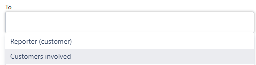

Dear @Eugene ,
"Notification Schemes" respect only JIRA Core/Software and SD Agents, but not customers (that do not consume a license).
Is the "particular Manager" a customer? If yes, you need to configure "Custom Notifications". Refer to this link for details.

When I try to configure "Customer notification"  I see this:
But the Manager is not a reporter and I wouldn't like to send a notification to all "Customer involved", only to a particular Manager.
