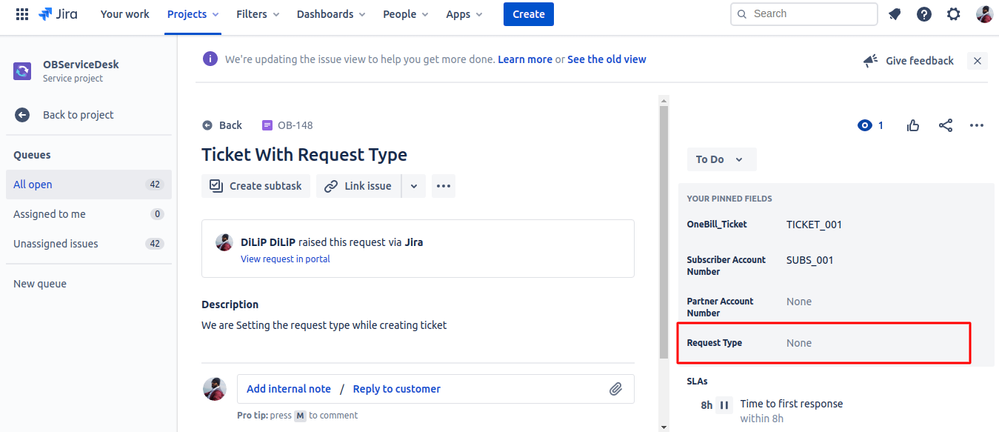

Now When Open the Issue in Jira, the field Request type is not set with any value. Please take a look at the following screenshot for highlighted section

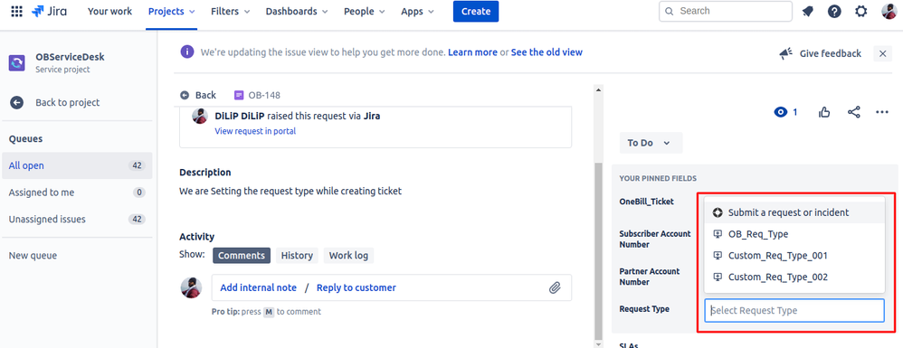

Now If I Edit the field Request Type then I'm able to see the drop-down values which is having the same which I sent in the request. Please take look at the following screenshot for highlighted section
