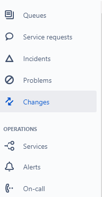

I Just Created Jira Service Project(using it service management template). But I am not able to find "Raise a Request" option in the Agent portal.
Could you please let me know the issue.

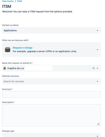

Testing on my local site, the “Raise a request” option is not visible on ITSM template, but it has the exact same functionality as the Channels > Help center.
Both options will redirect the agent to the customer portal to select the Request type to create a ticket.
That previous behavior that would open a popup window to create the ticket without going to the portal was removed a while ago and it’s not possible to add it back.

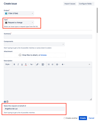

Also, if an Agent uses the “Create” button they can select the Request type and also use the “Raise this request on behalf of” that, once again, is the same as creating the ticket on the portal or using the “Raise a request”.
Create button:
Portal:

However, I do know the "Raise a request" does not exist in the sidebard for ITSM as you have seen for yourself. However, you can do so either via the Create button or if you wish to use the Customer forms then you can go to Channels and open the portal and do from there. In effect the "Raise a request" link is the same. Finally you could consider adding a direct link using the add item button. There may be a different solution from others that are actively using ITSM.
