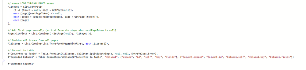

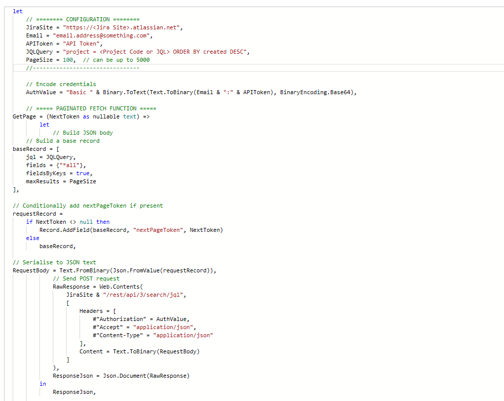

So this was a major head wrecker for me as my connection was a simple GET using the v2 Rest API link and just connecting from Power BI using my login and Token. Going into Advanced Editor was way out of my skillset - but I have some code which works!!!
So start with a New Source - Blank Query in Power Query in Power BI. Select Avanced Editor and delete what comes up. Then paste the code in below - changing the Jira Site, Email Address (used for making the API Token in Jira), and the Token itself. And the Jira Project Short Code you want to look up, or alternate JQL (it must be limiting). It should then get you to the same (or similar) starting point for the old GET v2 API connection. Hope this helps someone!!!!
PS apologies the forum won't let me post the code so I've provided it as an picture attachment and a link to a word doc below (expires 10 Nov 2026)
Jira connection Code.docx
