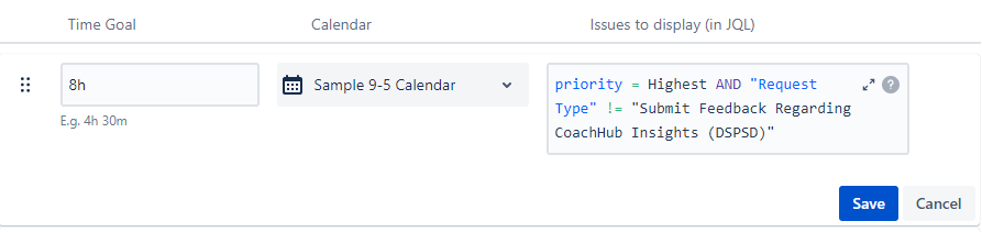

Hope some of you can help me figure it out if this configuration is possible.
In my Actual Project, I have a specific Request Type that is to collect Feedback (See screenshots attached). And as these tickets are only feedbacks about a product, I tried to turned off SLA for it, but is not working, I tried with JQL directly in the SLA configuration. (see screenshot)image (43).png
Is there any way to turn off completely SLA for this request type??

Hi @Lucia Ramirez ,
The JQL filter looks fine and it should work.
Did you make this config for all SLAs?
On screen with SLA config there is 8h but on screen with issue details there is SLA Time to resolution with 80h timer.

Lucia Ramirez
March 29, 2023
Hi @Rafał Chomik ! you are right! the project was taking other SLA for this specific Request Type. I was able to fix it. Thank you very much!!!

Emily Fox
January 4, 2024
Where is the screenshot showing your project setup? I don't see it and am running into the same issue.
Rafał Chomik
January 8, 2024
@Emily Fox as far as I remember, there was additional SLA where this particular Request Type was not excldued. Maybe you have the same problem. Check out all your SLAs if they have proper JQL to exclude Request Type that you don't want to count.

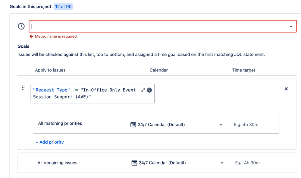

Sean Button
July 16, 2024
i see now JSM has an SLA catch all, "all remaining issues" with no way to customize exclusions via JQL, are you now having this issue @Lucia Ramirez , @Rafał Chomik , @Emily Fox
