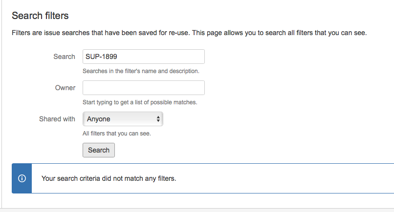

Nic Brough -Adaptavist-
April 10, 2017
That's searching for filters.  Sam is talking about searching for issues.
Go to the "issues" menu at the top, and you should find an option for "search" - click that and you'll be dropped into the "issue navigator", where you'll be able to search for "Project = SUP" to get all the issues in that project.
I reckon you'll want to refine that by status or resolution - "Project = SUP and resolution is empty" might be more useful!
