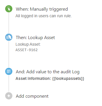

I am doing an asset lookup and I want to log the attribute values.  When I trigger my automation, the log shows that it was successful but all I see that is logged is Asset Information with nothing else logged.  Is my automation correct?  The ScriptRunner Documentation is not clear on how to log the attribute values.Screenshot.png

The information in the audit log should be
{{lookupObjects}}
You can also so
{{lookupObjects.Attribute Name}}
eg
 {{lookupObjects.Service Owner.accountId}}

Sorry for the delay in responding, I just tried changing {{lookupassets}} to {{lookupObjects}} and the automation still did not return the Asset attribute values in the audit log.
