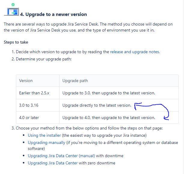

The below upgrade path is listed in this link: https://confluence.atlassian.com/servicedeskserver/installing-jira-service-desk-939926011.html
Are these instructions correct? "Upgrade path" for "4.0 or later" and "Upgrade Path" for "3.0 to 3.16) seems to have interchanged.
If we have version 3.14.0, can we directly upgrade to 4.13.1 and no need to upgrade to 4.0 first?
However, we have already tested upgrade on test server in above way i.e., directly upgraded from 3.14.0 to 4.13.1 (manual upgrade process) and didn't face any issue. I hope it is the correct process and we won't be facing any problems in future.
Nic Brough -Adaptavist-
November 26, 2020
I think that language is confusing.  The "upgrade to 4.0" is the problem, it's totally redundent.   You're already on 4.0 so you don't need to upgrade to it.
Unless someone has managed to mangle the table and should use your arrow to swap the two lines in those cells over!
But I've not seen or heard of any Service Desk upgrades going wrong when going from 3.0 or higher to the very latest in one step.  (Well, actually, I have had massive problems, but they have all turned out to be with the underlying Jira or apps, not JSD itself)
