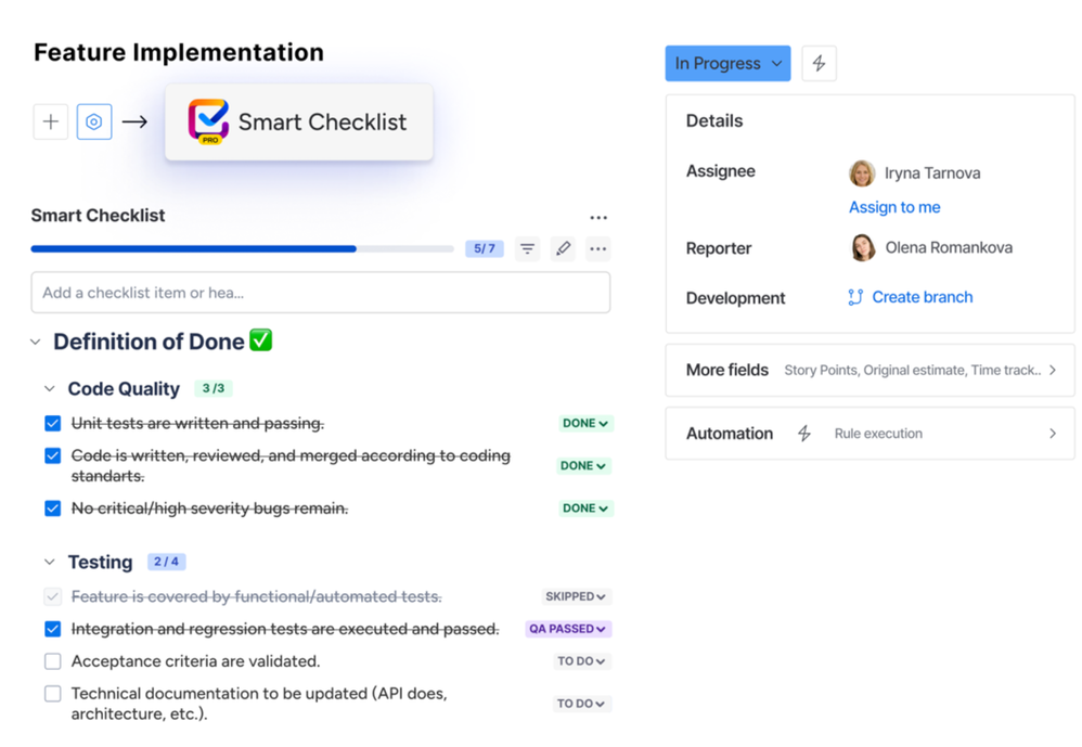

Create a request type like “Hardware / Server Decommission” under Service Requests.
Then add one checklist-style custom field (checkboxes) for the required steps — backup done, access removed, monitoring disabled, asset updated, etc.
Next, add one workflow validator on the Done/Closed transition that checks:
“All checklist items must be completed.”

Marc -Devoteam-
January 9, 2026
Hi @Hari Krishna
This does require a 3rd party app for embedding checklists in the instance.
