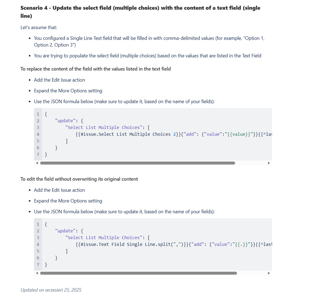

See this KB article; how-to-update-a-select-field-multiple-from-the-content-of-other-fields
Dominik Kaźmierski
January 12, 2026
Hello @Marc -Devoteam- and @Evgenii, thank you for your answers!
I used suggestions from the article, scenario 4
And there are some issues.

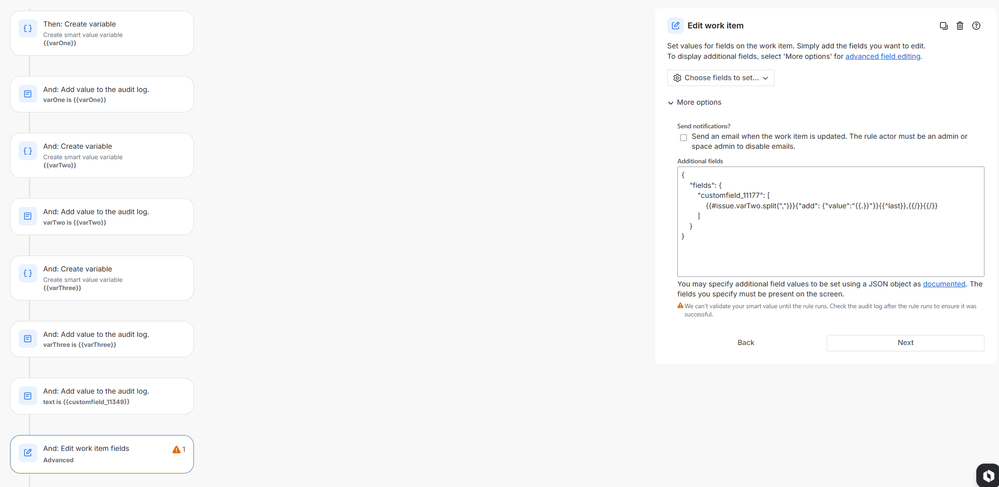

So here's my rule (version which run successfully but wipes data from the field/doesn't set provided values):image.png
{{varOne}} = {{comment.last.body.substringBetween("\"customfield_11177\": [", "],").trim().remove("\"")}}
{{varTwo}} = "{{varOne}}"
{{varThree}} = {{comment.last.body.substringBetween("\"customfield_11177\": [", "],").trim()}}
I tested all three variables to try out three different text formats

Bill Sheboy
January 13, 2026
Hi @Dominik Kaźmierski and @Marc -Devoteam-
Another possible cause of this symptom is when the JSON is invalid due to a racetrack timing problem.  That is, the smart value expression is not parsed fast enough before the JSON is validated / used in the advanced edit.
The mitigation / way to test for this is:
  • Use the Create Variable action to pre-build the JSON and store it in a variable, perhaps named varJson.  This will force complete evaluation of the expression before the next rule step.
  • Write the variable to the audit log to confirm it contains what you expect
  • Use the variable {{varJson}} in the advanced edit

January 12, 2026
Hi, @Dominik Kaźmierski
Welcome to the community!
You can achieve your goal using an advanced JSON action in Jira Automation. The key is to structure the JSON payload correctly to update a multi-select custom field based on values from another field.
Here’s a working example:
If you want to populate customfield_10123 (a multi-select field) with values from customfield_10321 (e.g., a text field containing comma-separated values), use this JSON format:
This uses smart values to split the string by commas, iterate over each value, and add it to the multi-select field. The {{^last}},{{/last}} ensures proper comma placement in the JSON array.
"update": {
"customfield_10123": [
{{#issue.customfield_10321.split(", ")}}{"add":{"value":"{{.}}"}}{{^last}},{{/last}}
Alternatively, if you're working with Fix Versions or similar system fields, you can use:
"update": {
"fixVersions": [
{ "add": { "name": "{{ExistingFixVersion}}" } }
For more guidance, refer to Atlassian’s knowledge base, that earlier shared @Marc -Devoteam-:
https://support.atlassian.com/automation/kb/how-to-update-a-select-field-multiple-from-the-content-of-other-fields/
