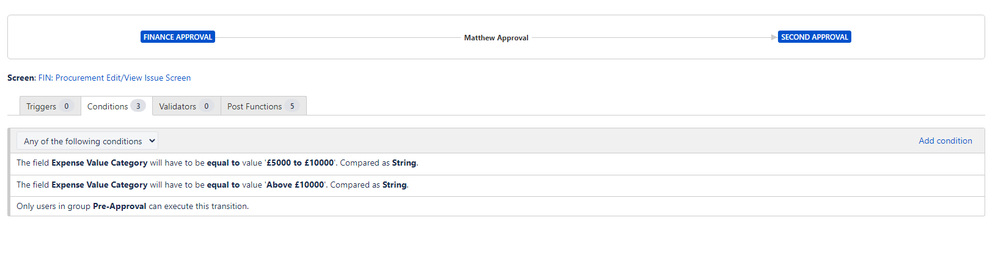

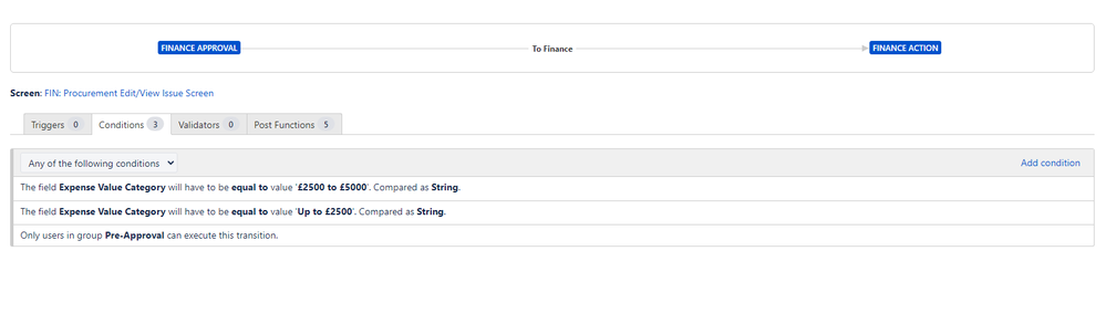

These are the conditions the same in both workflow statuses so only users in the group Pre-Approval should see the Finance Action step but only if the custom field equals any of the two categories.
The 2nd condition below is the same but the value categories are different.
What I am seeing now is anyone in the group can see both sets of status options regardless of the value category set.
Hope that makes sense.

Yes, it does, I think you've misunderstood how conditions work, and I'm not sure if your logic is flawed as a result!
Both your screenshots have the same problems, and there's three potential problems compounded.
Your first screenshot says (I'm shortening this a bit)
  • Any of the conditions
    • The field EVC will have to be equal to "£2500 to £5000", compared as a string
    • The field EVC will have to be equal to "Up to £2500", compared as a string
    • Only users in the group Pre-Approval
Problems
Is EVC a drop-down field?  With options of  "£2500 to £5000" and "Up to £2500", with those exact names?
Which condition are you using for this comparison?  Is it "value field"?
And probably the main one - the "any" at the top means "or".  You're saying "let this happen if EVC = "£2500 to £5000" OR EVC = "Up to £2500" OR the user is in Pre-Approval group".  I suspect you want to swap that to "and", and try again.
