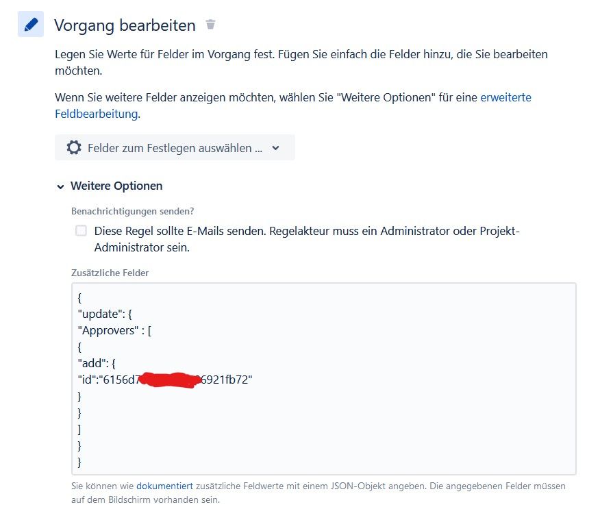

I have now found out myself.
You have to adjust the workflow and change it to "all" so that all have to approve.
And with the automation you have to select the action: Edit process and here not select the field approver but in the additional fields add the whole manually. If you select the field directly from the dropdown, i.e. "Approver" and you make an if query, the approver is always overwritten, which is why you have to do the whole thing in the .json with "Add".
Then it also adds multiple approvers and you can query individually by category and add different approvers.
Unfortunately you always have to copy out the ID of the user, but at least it works like this :)
This is the code:
    "update": {
        "Approvers" : [
    "add": {
    "id":"6156d7XXXXXXXXX21fb72"

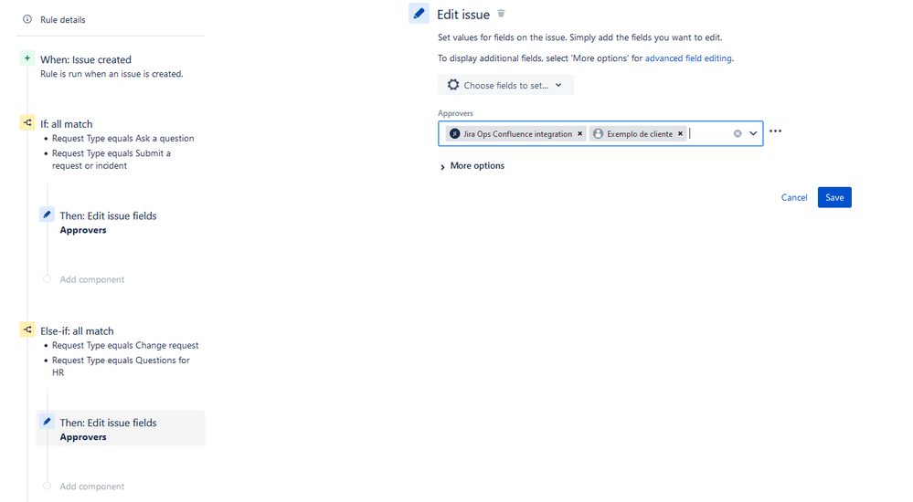

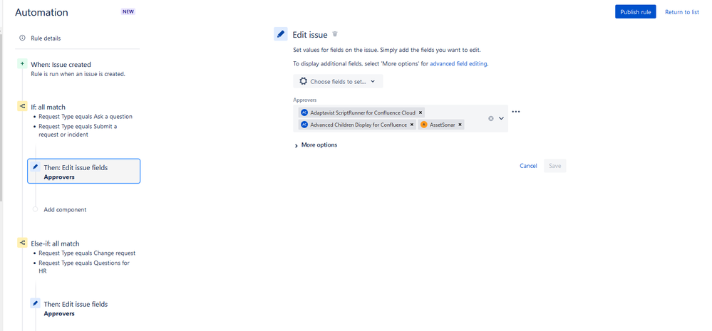

@Mergim Rexha but in automation you can do this usually, follow the examples
And the second condition
For everyone to approve, you just need to edit the workflow for everyone to approve
