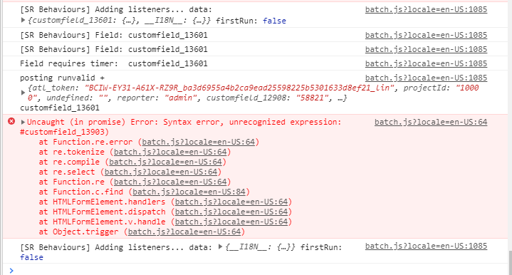

Here is the error I see from the browser console log
Previously, my code was working fine. Until, recently, my colleague did Jira version upgrade. So, I suspect it might due to some other plugin that cause this error?
