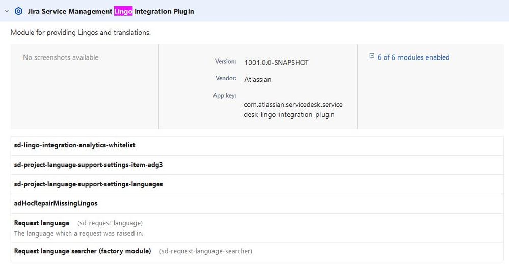

I'm running into an error relating to a Jira Service Management Lingo Integration plugin. On Jira Cloud, the plugin exists but it's not imported to my temp instance.
This is the plugin on Cloud:
When I use Project Configurator to export a project from the temp DC, it shows:
Found custom field with values for issues in exported project(s), with id: 11100, name: Request language and type: com.atlassian.servicedesk.servicedesk-lingo-integration-plugin:sd-request-language. This field does not exist. Check if its type is defined in a plugin that has been disabled.
