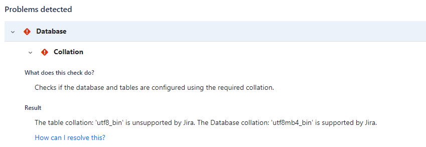

May i know below collation_name is wrong or correct?  MySQL version is 5.7.
I did follow this  How to Fix the Collation and Character Set of a MySQL Database, still having the error below.
DPKJ
October 14, 2019
Casper `utf8_bin` is not correct if you are using Jira 8+. You need to migrate your database to `utf8mb4_bin` to get rid of collation error in health check.

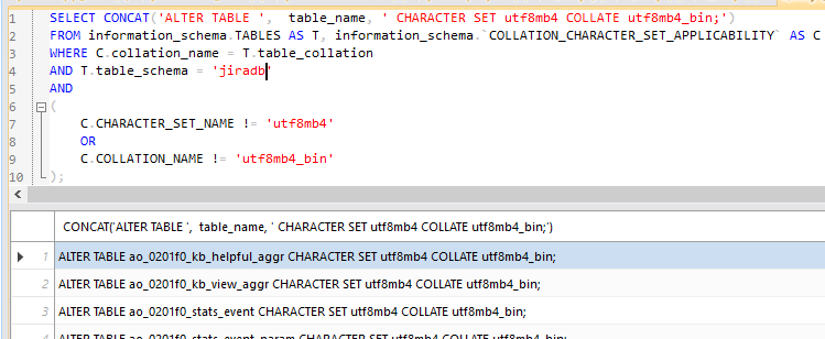

hi, thanks for the reply, do you mean below queries?
i did the below queries , still getting the same out put ...
SELECT CONCAT('ALTER TABLE ',  table_name, ' CHARACTER SET utf8mb4 COLLATE utf8mb4_bin;')
FROM information_schema.TABLES AS T, information_schema.`COLLATION_CHARACTER_SET_APPLICABILITY` AS C
WHERE C.collation_name = T.table_collation
AND T.table_schema = 'yourDB'
AND
    C.CHARACTER_SET_NAME != 'utf8mb4'
    OR
    C.COLLATION_NAME != 'utf8mb4_bin'
DPKJ
October 14, 2019
When you run this query you will get bunch of queries as output, and later you need to run these queries to get desired output.
Casper
October 14, 2019
like below right?
after that which queries should i run ?

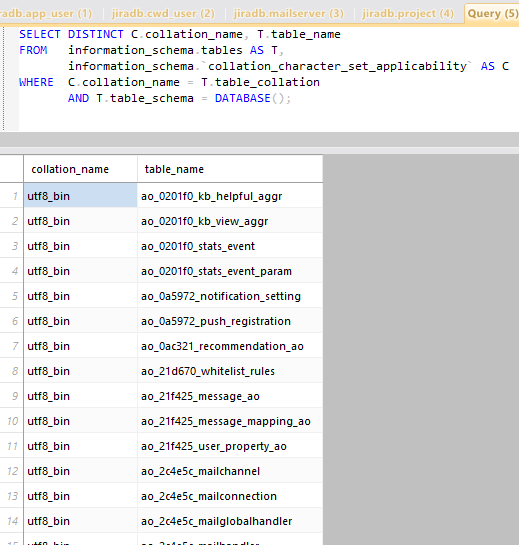

Casper
October 14, 2019
I already run, but my out put still the same with utf8_bin, may i know any other way to fix this ?

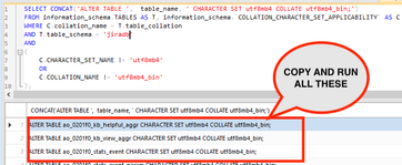

@CasperHere are steps that I followed
  • Shutdown Jira
  • Backup database
  • Alter database collation,
    • Run query 'ALTER DATABASE jiradb CHARACTER SET utf8mb4 COLLATE utf8mb4_bin'
  • Alter table collation,
    • Run query
    • SELECT CONCAT('ALTER TABLE ',  table_name, ' CHARACTER SET utf8mb4 COLLATE utf8mb4_bin;')
      AND
          OR
    • This will return list of alter statement in output console, copy these and run again
