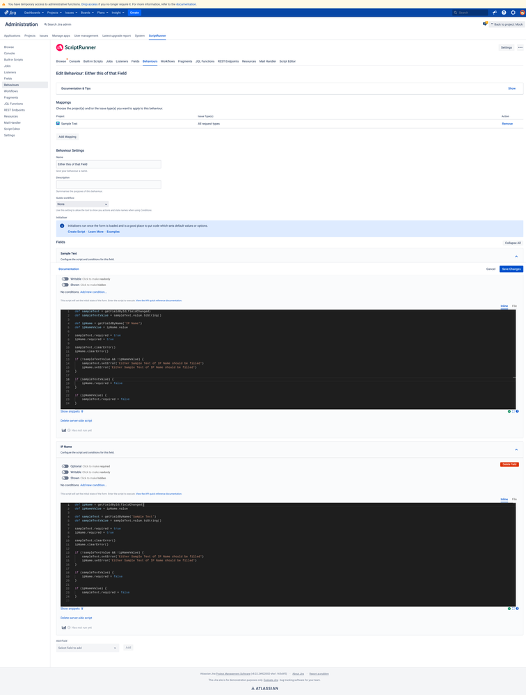

Below is a screenshot of the Behaviour configuration:-
Basically, what the Behaviour configuration above does is that if fields A and B are not filled, it will display a field error on both fields. If either one of the fields is filled, the error message is removed, and the 2nd field that is not yet filled will become optional.
