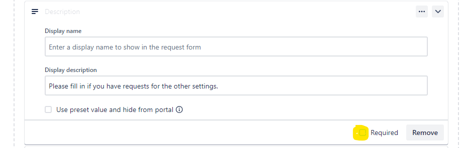

Just go to Project Settings > Request Types > Click on the request type in which you want to make field mandatory & then on the field & you shall find a check box to make field mandatory, like below.

If you set it inside the request type configuration you should be able to make it optional for any other request type, like @Vishal wrote.
If you set it required via the field configuration, then it will be required for alle issue types and request types.

I indeed did it via the field configuration, seems like i was blind.
I haven't seen the checkbox @Vishal  mentioned. :'D
