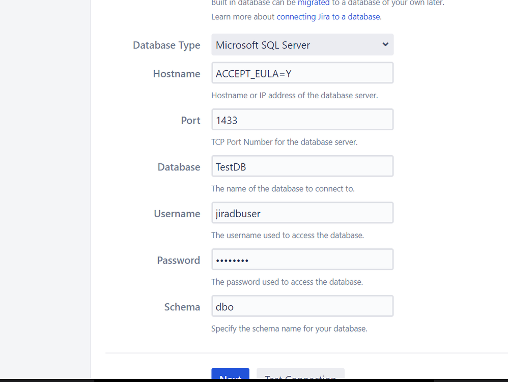

Hello  Team,
This Qs is outof Jira cloud domain , I installed Jira on Docker and try to connect with MS SQL server which is running on Docker too. I Installed SQL server from the following link ,
https://docs.microsoft.com/en-us/sql/linux/quickstart-install-connect-docker?view=sql-server-linux-ver15&pivots=cs1-bash
Can you please help me in knowing exact parameters while setting up database .. I am getting some error while testing connection
Thanks,
Faisal
Faisal Shamim
January 26, 2021
