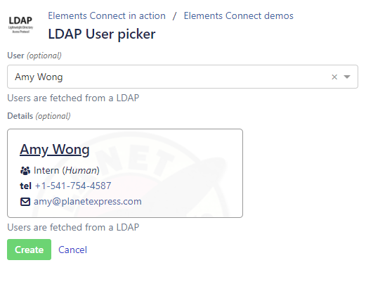

If the information is already stored in an external datasource, you could consider using the Elements Connect plugin to retrieve it. You can see an example below- based on a field selection (User in this case), a new Details field auto populates with information pulled from the datasource.
