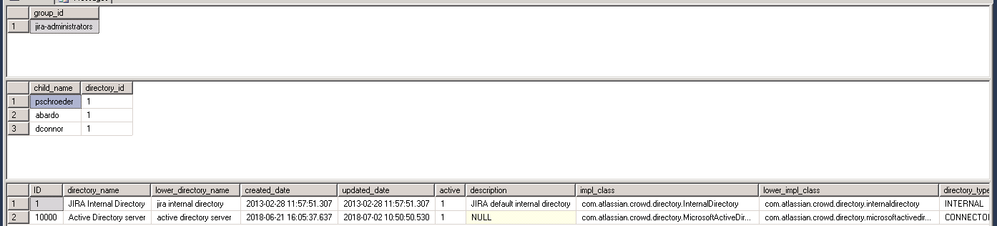

Philip Schroeder
July 2, 2018
Thank you. I have attached a screenshot of the results. For the third table, Jira internal is position 1 and active directory is position 0.
Andy Heinzer
July 2, 2018
Hi Philip,
In the last query I was looking to see the value in the directory_id field for each, but it looks like it could not be displayed in the screenshot.
But we can still reorder these directories via SQL
  1. Stop Jira
  2. run
    update cwd_directory set directory_id=0 where id=1;
    update cwd_directory set directory_id=1 where id=10000;
  3. Start Jira again
This should reorder the directories to allow the internal to be on top again.  From there you can then login as any one of the 3 sys-admin accounts, using the previous username/passwords that Jira has stored in the internal directory for those accounts.  If you can't remember those passwords, then you can also update those passwords via SQL with a command such as
update cwd_user set credential='uQieO/1CGMUIXXftw3ynrsaYLShI+GTcPS4LdUGWbIusFvHPfUzD7CZvms6yMMvA8I7FViHVEqr6Mj4pCLKAFQ==' where user_name='example'
If you replace that example username, this sets the password to be 'sphere' (no quotes).
This should at least let you login to Jira as an admin once more.   From there I would recommend that you create an internal system admin account in Jira's user management, and give it a username that does not exist in the AD.   This way should you reorder the user directories in Jira later on, this account can still login with the internal account credentials.
IT Tech
July 5, 2018
That did it! I had to change the column heading but other then that it worked great and I am back in!
