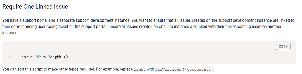

In the first reference link mentioned above, there is already an example for making linked issue required as documented in ScriptRunner documentation -

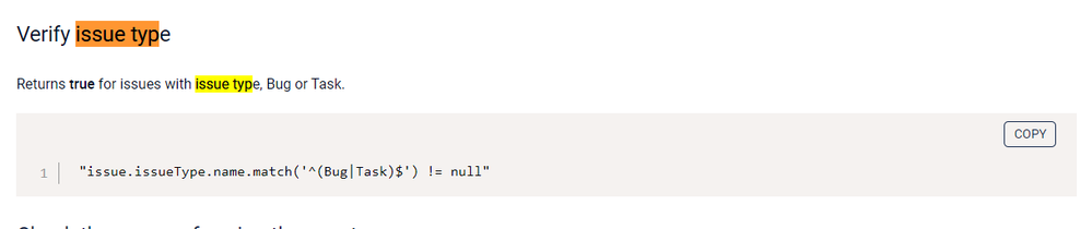

Lastly from the same example documentation - here is the code checking for issuetype (where you should combine it with the linked issue setup at a high-level)

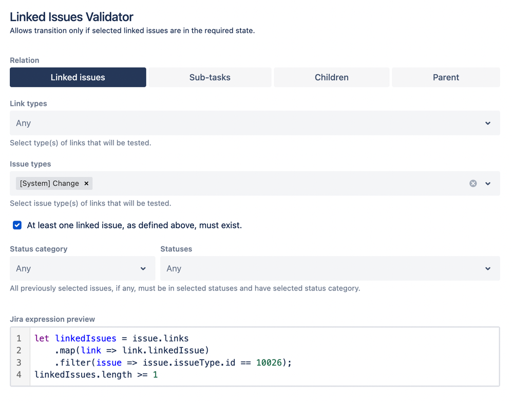

I am from Forgappify, and we couldn't find an easy way to accomplish this in Jira Cloud using other apps, and it is not possible in Jira out of the box. Therefore, we have created the Linked Issues Validator as part of the free Workflow Building Blocks for Jira app.
Please take a look at the configuration below. You can select the issue type of the linked issue that should exist. To make it required, check the "At least one linked issue, as defined above, must exist" box.
