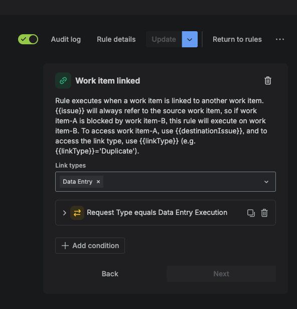

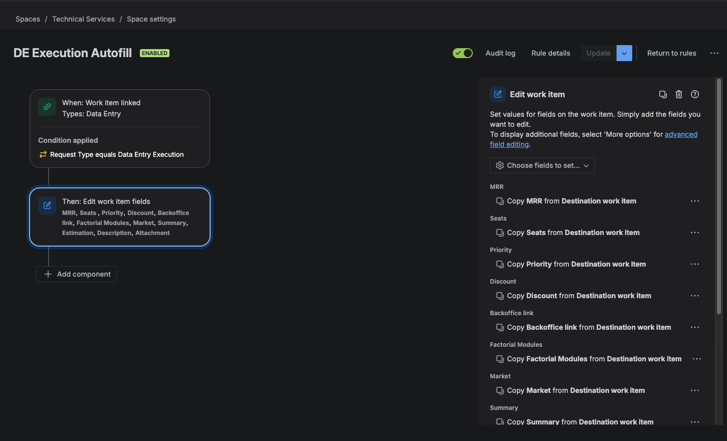

What I would like to achieve is to link that estimation ticket to the execution ticket and bring the information from the estimation to the execution ticket, I already was able to link the ticket using smart values and the advanced field but my problem is the autofill.
The trigger in the autofill is "when an issue is linked" but the event on the advanced field modification is "work item edited" so the trigger is never met and the automation never triggers.
I wanted to try and use Smart Values in order to collect the information, but on the option of copy I can only copy from 2 sources
Is there any way to bypass this limitation without using "elements connect" or another plugin?

Simplest is to execute the link action in the Estimation ticket, then in the edit copy the values based on the option Trigger Issue.
The other way around as you do now is moer complicated, as you would need to find the linked issue via a lookup action and then set each field in the Execution item with a smart variable.
e.g. {{lookupIssues.MRR}}
Or even simpler and maybe the easy way.
Create an automation with a manual trigger that can be executed on the Estimation ticket, in that rule just have a create work item action, within the create action you can set all required fields , use copy from trigger issue for the fields and you can link the items as well

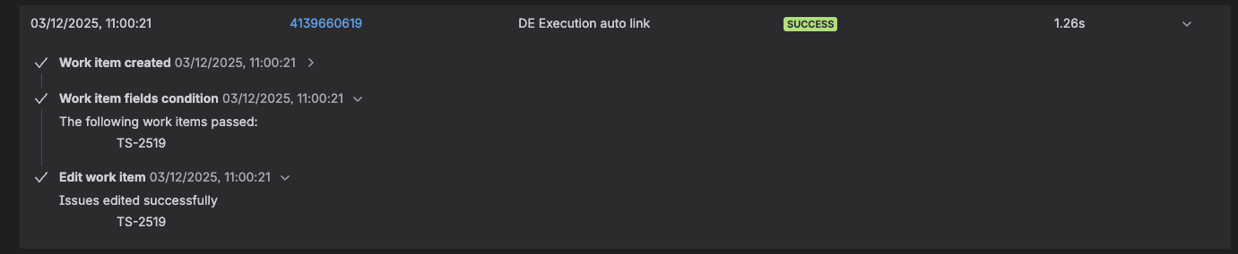

This part works perfectly. My problem is the second part which is the "Auto fill" of the ticket.

Hi @Marc -Devoteam-  Thank you so much for your reply.
Unfortunately I need to proceed with the cumbersome solution due to the fact that the Estimation ticket can be closed long before the Execution ticket is created. And the main Idea is that having an Estimation ticket is a required condition to create the execution one.
The autofill automation works fine if I remove the link and recreate it again, which makes me sad.
To be honest I was thinking about your solution (The cumbersome one) and I think it's even more complicated since I would have to create variables for each field I want to auto fill and assign values with the lookup function with a JQL. I don't think there is a better way to do this. Or at least not that I can think of At the moment
