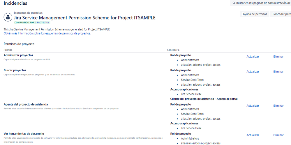

Logre configurar el esquema de permisos del proyecto, aún asi no logro comprender del todo el funcionamiento

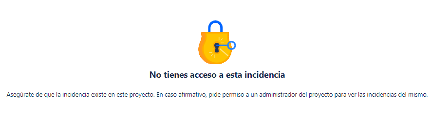

Una vez establecido cargue un ticket nuevo y no puedo visualizar
Donde establezco quien exáctamente puede ver el ticket??JIRA-visualizar tickets..png

You will need to ensure that you (your account) are being called out in the security level that your issues are associated with.  Only the users who are called out to the appropriate security level can access the issues once the issues are tagged with the security level.
Example - If you are a member of the project's Administrator role, then your security level configuration must include the project Administrator role.

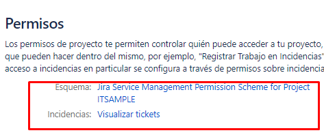

Gracias por su respuesta, sabrias cual es la opción para limitar la visualización de las incidencias en este menu? Jira-Permisos2.png

@Marcelo Caceres -
The project permission scheme controls the general access/rights for users to your project.  The "Browse Project" permission just control who can access the project or not.  It has nothing to control down to specific issue access.
However, if one cannot access the project, then it is a mute point about trying to access the specific issue within a project.
