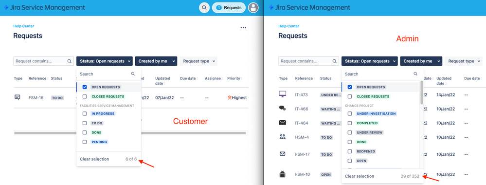

The filters on the customer have changed a while ago. It’s possible to view all the statuses of projects that you have access to.
You as an administrator will be able to view all projects because you have permission.
If a customer accesses the portal and goes to Requests > Created by me they will only see statuses of projects they have permission.

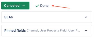

Regarding showing closed tickets, it’s due to the resolution.
Tickets are only considered Closed if they have a resolution. If a ticket is transitioned to any “Green” status, for example, Closed, Resolved, Completed, but without a resolution, they will still show under the Open requests filter.
Please, confirm if the Closed tickets have a Resolution.

Problem is that the customers have exact the same view than the admin.
Angélica Luz
January 17, 2022
Hi @Nele De Pauw,
If customers can see projects they are not supposed to, it means that the project is open or, if it’s closed, they were manually added by an agent or admin or an organization they are a member of was added to the project.
To check their permissions, go to Project settings > Customer permissions (company-managed) or Project settings > Channels > Customer permissions (team-managed), and on Service project access select Customers added by agents and admins > Save
After that, all customers that weren’t manually added, won’t have access to the project via the customer portal.
If it still persists, go to the Customers’ page and check if the affected customers are listed there and remove them from the projects you don’t want them to view in the portal.
It’s necessary to do this on each service management project.
