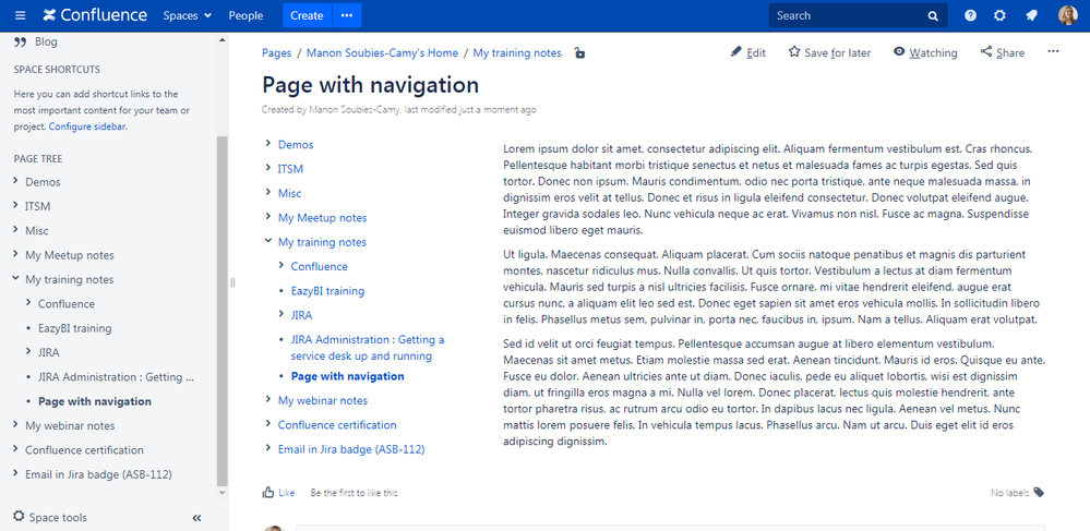

I don't think there's a way to add the same navigation bar on the Service Desk portal than in Confluence itself, but you could achieve something similar using the Page tree macro and configuring the page layout in Confluence. It looks like this once published:
And here is the editing view:
Note that in this example I've set up the root page as the home of the space, but you could use the parent page as well (replacing @home with @parent in the Page tree macro parameter), it could make sense in a service desk scenario.
I haven't tried to see what it looks like from a Jira Service Desk portal but I think it would work well!

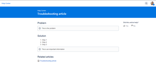

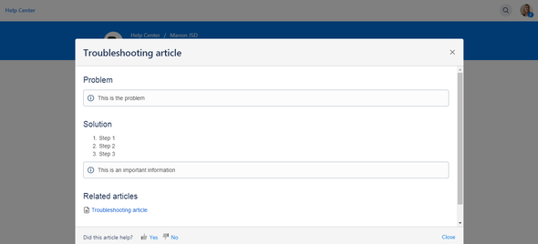

The article display actually depends on whether you're reading it from a request form:
Or from the help center:
I don't think you can change the width of the article - it may be possible using Refined Sites but we're limited with Cloud so I'm really not sure you can tweak that.
