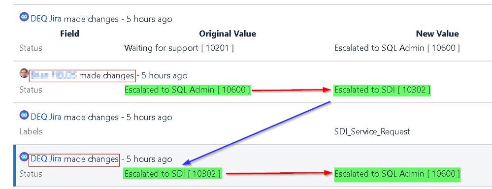

Hello there,
I'm troubleshooting an issue where a service desk member escalates a ticket to another group (status) and Jira reverts back to the original status. As you can see from the history screenshot, service desk tech changes status from "Escalated to SQL Admin" to "Escalated to SDI" but then Jira reverts it back to "Escalated to SQL Admin".

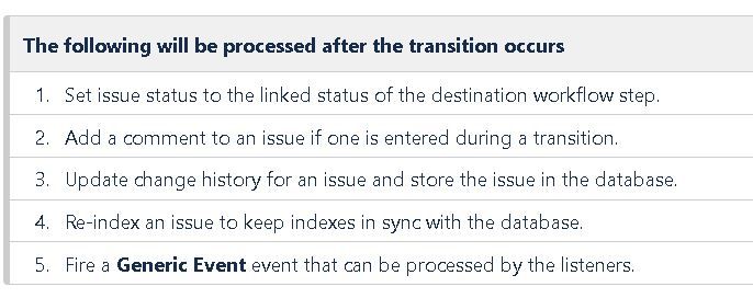

As far as post-functions go - this particular transition has a canned post-functions, like other transitions.
