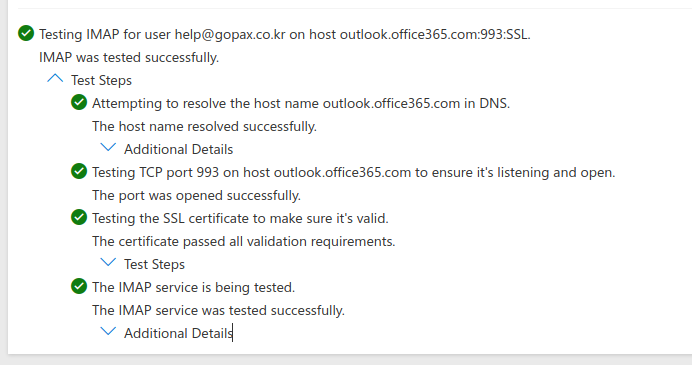

1. Make sure "IMAP4" is added to Client Access Rules in O365, and when testing the input in O365 using Jira context, the test is completed successfully.

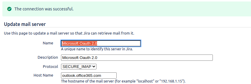

2. You can solve this problem by using OAuth 2.0, which is supported in Jira 8.10 and later.
