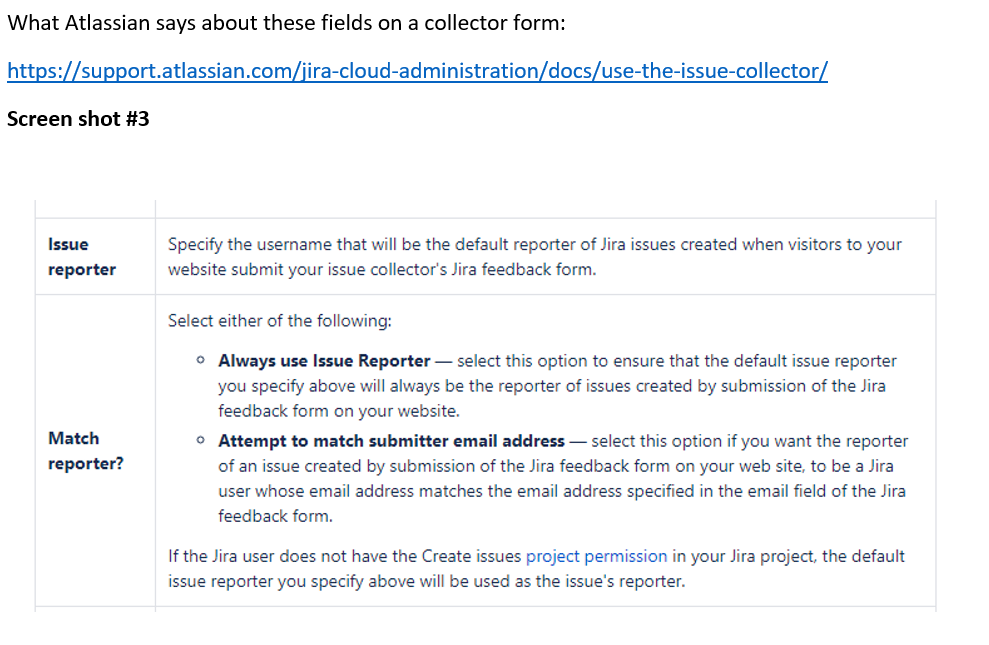

Based on reading I did here https://support.atlassian.com/jira-cloud-administration/docs/use-the-issue-collector/ -see screen shot below  – I am guessing it may be due to the reporter field where we chose the option "Attempt to match submitter email address" as we do not want to default to our name but the person reporting it so we know who reported.
Per your article above about issue collector reporter field it looks like that it should default to the default reporter we mentioned if it doesnt match users email address within Jira -assuming he/she is not a Jira user (hence no create permission to our project)
Can you tell us how to address these errors? Unfortunately  we cannot know all the  users to add them to Jira. Is there a way to get all users to use this form without granting default create permission on our project space to avoid this error or be within Jira?
Bottom line we want the form to work for all our users and also need a way to know who submitted it versus defaulting the reporter to always my name. Pls guide.
