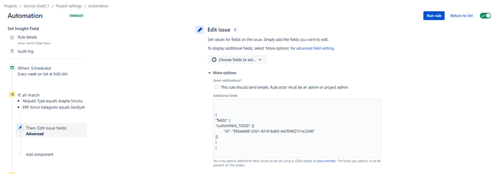

Muhammet Ayal
May 28, 2022
Hi Team,
This is work for me, thanks
"fields": {
"customfield_10520": [{
"id": "956a4a68-32e1-4216-bab3-edcf04027c1e:2248"
