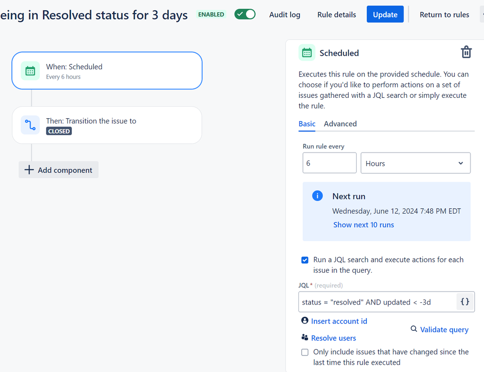

Anyway here is a screenshot of one my Rules.
Notice the "Only include issues that have changed since the last time this rule executed" message - I hope you don't have that checkbox checked.
