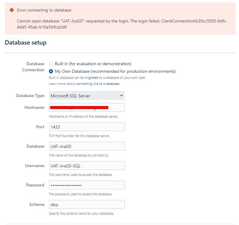

Hello,
Thanks for your answer. Here is a screen capture of the error and some parameters of the SQL server setup menu. Thanks!

Nic Brough -Adaptavist-
July 26, 2021
Ok, that's pretty clear.   Either that database does not exist, the username/password are incorrect, or that user does not have access to that particular database.
Can you connect to it with a database command line or maintenance tool?

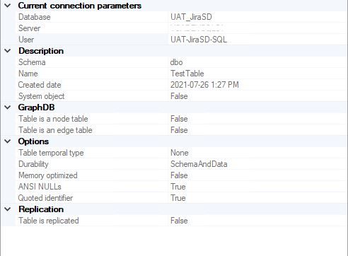

Eliane Champagne
July 26, 2021
Hello Nic,
Thanks for your input.
I am able to log onto the SQL server using SSMS and username and password. From there, I am also able to create a table and enter data. See enclosed screen capture down below. That specific table was created using the same user as I use in Jira Service Management configuration page.
