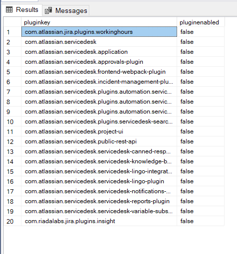

Hello,
I had some problems with Jira Service Desk after the update to 8.19. It was displayed as "you got a license but its not installed." Installing resulted in an error.
However I did a complete reinstall and everything went fine (complete clean install, no LDAP, nothing, no restore, no data, version 8.20.0). I installed Service Desk and added my License. After a restart its "not installed" again.
Why does it stop working after some restarts and is set to false?
/****** Script for SelectTopNRows command from SSMS ******/
SELECT TOP (1000) [pluginkey]
,[pluginenabled]
FROM [XX].[dbo].[pluginstate]
___ FAILED PLUGIN REPORT _____________________
1 plugin failed to load during Jira startup.
'com.atlassian.jira.mobile.jira-mobile-rest' - 'Mobile Plugin for Jira Data Center and Server' failed to load.
Application context initialization for 'com.atlassian.jira.mobile.jira-mobile-rest' has timed out waiting for (|(&(objectClass=com.atlassian.servicedesk.api.ServiceDeskService)(objectClass=com.atlassian.servicedesk.api.ServiceDeskService))(&(objectClass=com.atlassian.servicedesk.api.organization.OrganizationService)(objectClass=com.atlassian.servicedesk.api.organization.OrganizationService))(&(objectClass=com.atlassian.servicedesk.api.queue.QueueService)(objectClass=com.atlassian.servicedesk.api.queue.QueueService)))
It has the following missing service dependencies :
&serviceDeskService of type (&(objectClass=com.atlassian.servicedesk.api.ServiceDeskService)(objectClass=com.atlassian.servicedesk.api.ServiceDeskService))
&queueService of type (&(objectClass=com.atlassian.servicedesk.api.queue.QueueService)(objectClass=com.atlassian.servicedesk.api.queue.QueueService))
&organizationService of type (&(objectClass=com.atlassian.servicedesk.api.organization.OrganizationService)(objectClass=com.atlassian.servicedesk.api.organization.OrganizationService))
