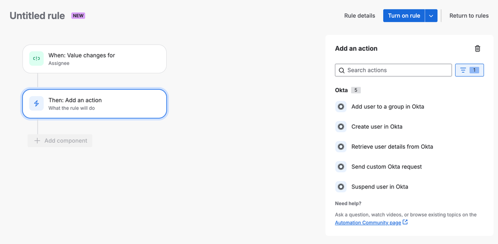

I have implemented this before with the Okta automation integration:
https://support.atlassian.com/cloud-automation/docs/use-automation-with-okta/
How this looks like:
1. If you have the employee email address, use the create a user action
2. After, retrieve the user's details (id specifically from Okta) using the get user details action
3. Add the user to the appropriate groups in Okta that provide the application access required
In case there's anything custom you need to do, you can use the Send custom Okta request option where you can do a custom REST API call.
Hope this helps!
Andrea
