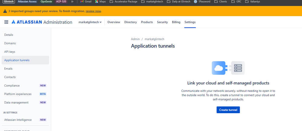

You have Jira server, and JSM cloud and you want them to talk to each other?
If I'm wrong about this, then I apologise but could you not use the Application Tunnel
Cheers

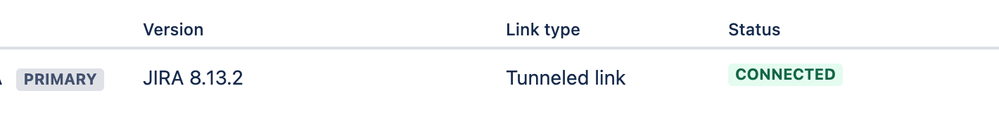

Thank you for your reply. Well, I have the tunnel up and running:
And I'm able to link issues between instances manually.
Like # people like this
