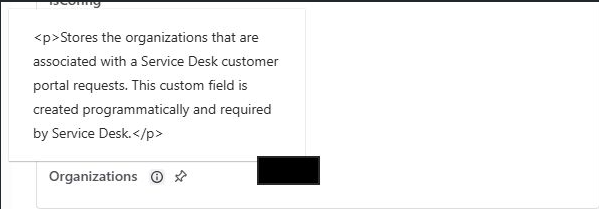

We are experiencing an issue with the auto populating of the organizations field within the Jira Service Management project.
As seen in the screenshot below, this Organizations custom field is built into the system from the Jira side and is a requirement. What usually happens is when a user at one of our customer's logs a ticket this Organizations custom field will auto populate the org name under which the user is registered.
Recently we have become aware that on a daily basis this pre-population is failing but only on a small % of tickets. For example Weds last week we had 23 tickets logged, and 7 didn't auto populate the organization name in this organization custom field. The % is always different, sometimes more, sometimes less.

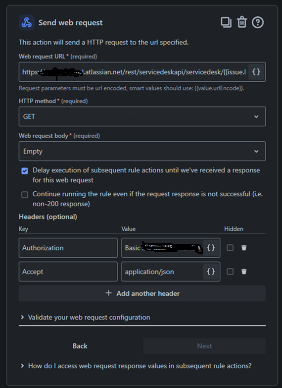

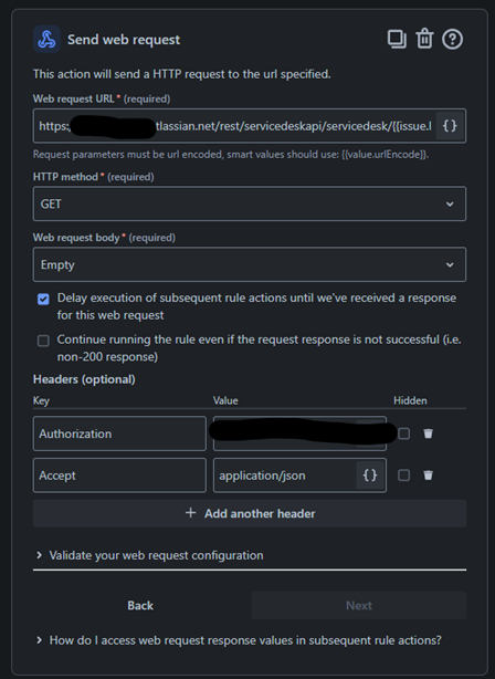

The automation goes something like this.  I would engage Support if there are any questions/issues.
It updates the Organization of the issue with this code:
"update": {
"Organizations":
{{#webResponse.body.values}}
{"add": {{id}} }
{{^last}},{{/}}{{/}}
The API call is something like this:
AtlassianOrgAutomation2.pngYou are using an API call to go into the Reporter of the issue and grabbing their Organization. Then saving that as the Organization for the JSM Ticket.  These screenshots are probably all changing with the new Automation token stuff, but that's what I have.  And I couldn't put in the exact info, as you'll need to use your token info.  If you have questions on the API stuff, I would go through support.  I'm by no means an API expert.  Make sure you vote for JSDCLOUD-15131
