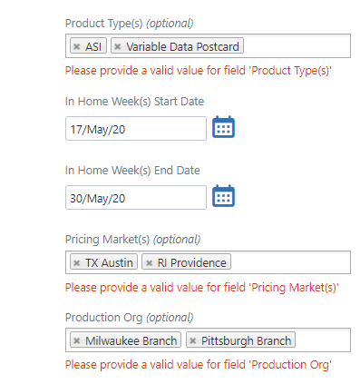

The service desk side will not allow multiple selections, only if a single option is chosen.
Changing these works in the non-service desk view of the same field.
Is anyone aware of this issue and/or a specific workaround for it?

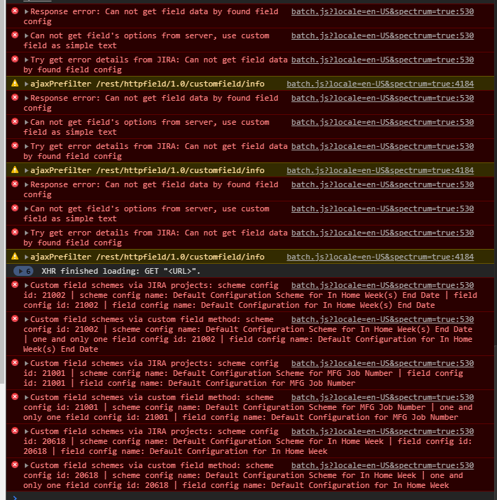

This may help as well. We see this on the console on page load (and we don't see this on request types where we don't have multiselects.
Nic Brough -Adaptavist-
May 23, 2020
You are not looking at the right thing.  You need to look at the validators or code that you have put in that is generating that "please provide a valid value"

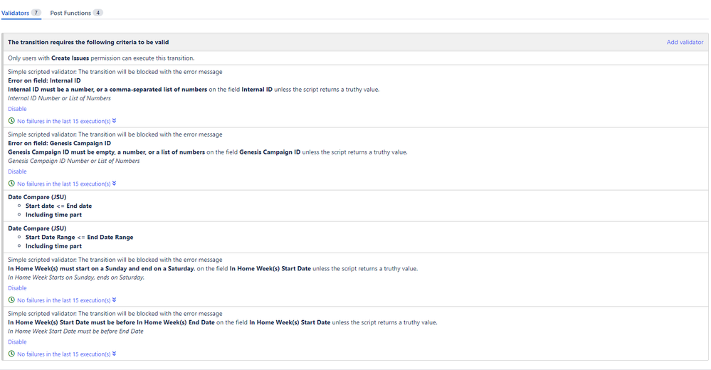

These are the only validators we have in place.
May 26, 2020
So where is that message coming from?  It's not a native Jira message.

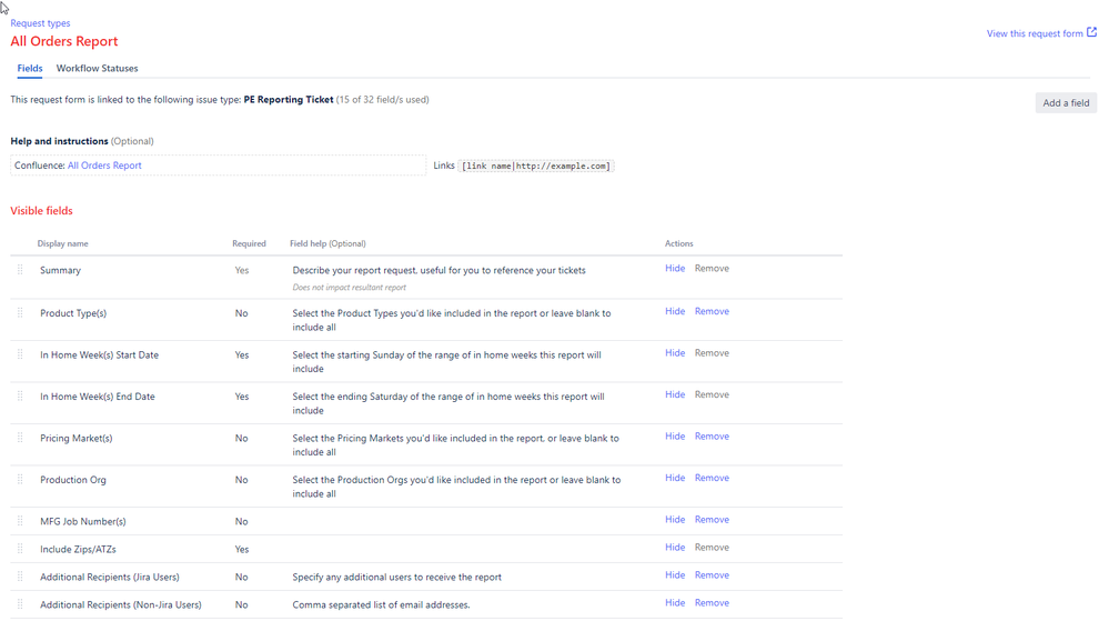

Can you screenshot
1: The request type configuration
2: the custom field configuration.
Not that I have any particular idea, but its something else to look at for oddities.

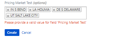

msheffey
May 26, 2020
No luck in incognito. Still happens with any multiple selects. (see below) For what it's worth, we also created a separate request type with a newly created multiselect and got the same thing.

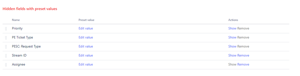

May 26, 2020

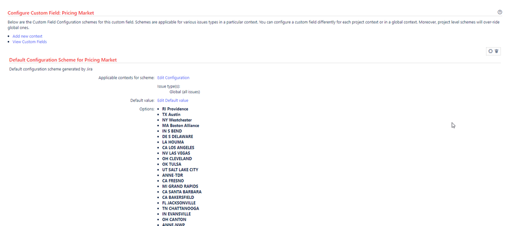

Custom field config example below
msheffey
May 26, 2020
Request type config below:
