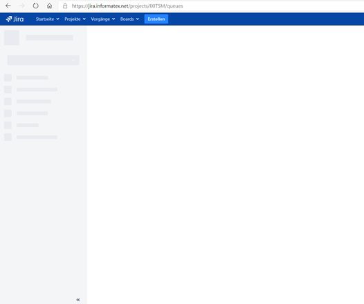

If i try to open a Service Desk projekt from the navigation pane, jira service desk shows a blank page with no content except the navigation pane. (see screenshot 1)
After some page reloads (Refresh / F5) the page is shown correctly.
This issue only occurs with Service Desk Projekts - all other Jira projects are shown correctly.

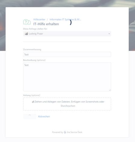

The same issue also occurs if i create a new request in the service desk portal. (see screenshot 2) The request is created correctly but the screen stucks as in the given screenshot.

@Ludwig Psaar what JSD version are you using. Any extensions in Firefox or just a plain new installation? What version of Firefox? Google delivers various answers to the error message pointing to browser addons.

@Fahad Siddiqui I'am using JSD Version 4.13.0... I can reproduce this issue on Chrome, Firefox and Microsoft Edge on different devices. All browsers are up to date.

what happens in the $JIRAHOME/log/atlassian-jira.log file when you recreate this problem.   It seems clear that something is getting stuck here.  I suspect there is a problem with the way the page is rendering, or that the page is unable to recover from a first attempt to submit.
In addition to looking at that log file, it would probably also help us to gather a HAR file from your browser session in order to understand what error messages might be logged there as well.

@Ludwig Psaar  here i can only suggest to Force garbage collection and log out and login and check

@Fahad Siddiqui i would like to inform you that i solved my mentioned issue. I analyzed my network activities during the requests and found some 400 errors in the log.
With these information i found a solution in Jira Knowledge Base Article. This problem occurs due to the URL Length Limitation of Microsoft Windows. I changed some registry settings to handle larger URL requests and restart all services. Now the problem is fixed.
