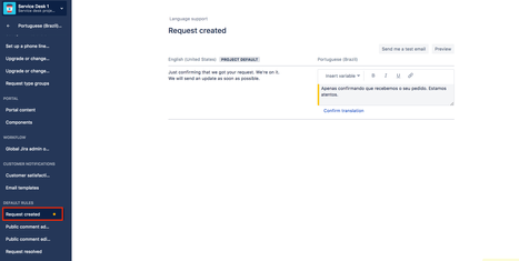

When the notification does not change the text, it is usually due to the default language.
I'll give you an explanation for you to check if perhaps is this issue that you are facing.
If you add Spanish, for example, and set this as the default language of the project, you will have to confirm the translation from English to Spanish, so it will reflect on the notification.
Here is an example, I added one more line on the notification and then change the default language to Portuguese. We can see that only the first line of the notification was translated, so it's necessary to translate to Portuguese and confirm the translation.
So, if that's the case, please go to the Project Settings > Language Support > Select the language and if there is an issue with the translation, it will show a yellow dot.

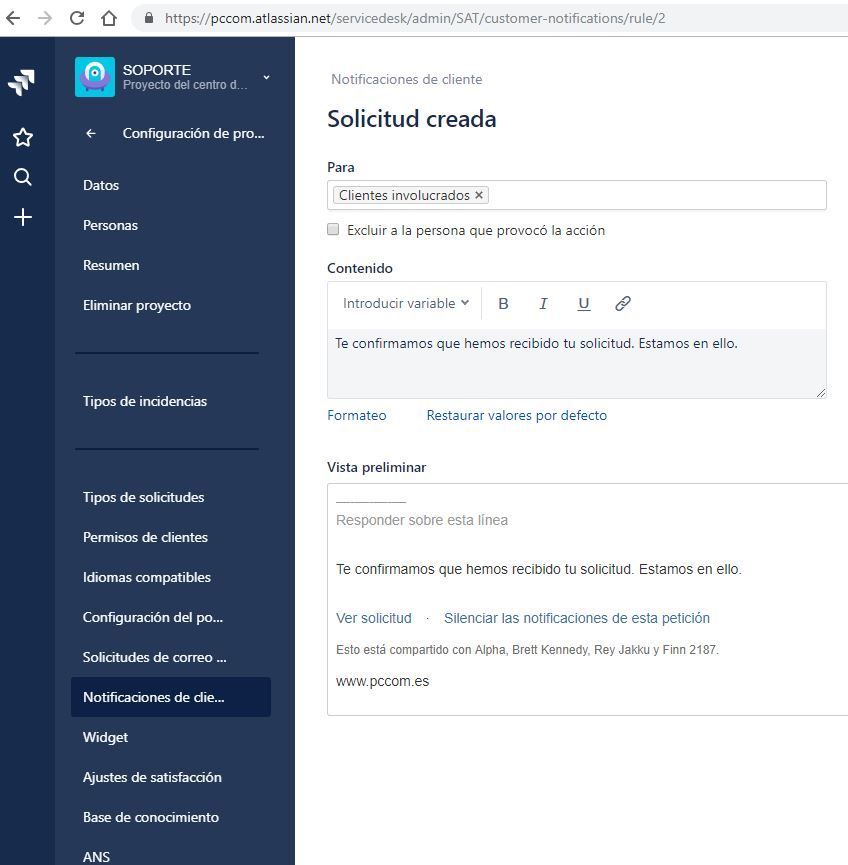

Paco Monfort
December 12, 2018
that's not the case.
i tested only create notification.
I share 2 screenshots of our actual configuration and one of the mail notification received.
