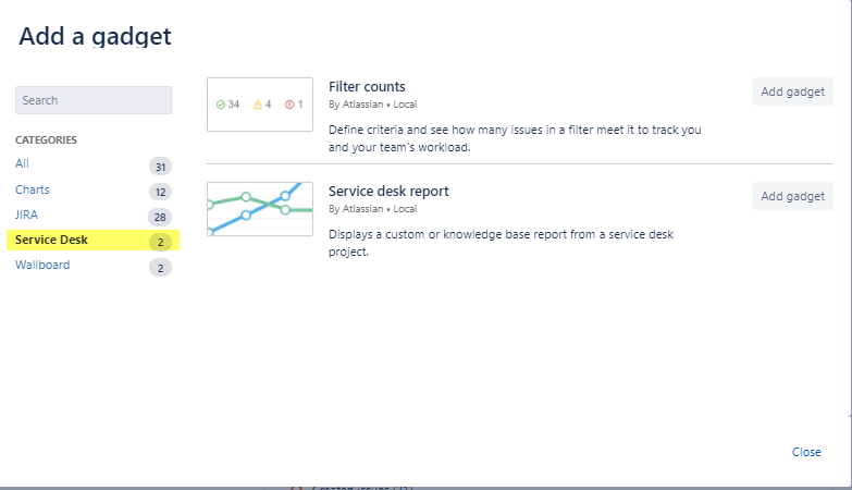

I saw only 2 reports type available in Jira service desk. I wanted to customize to include request type as the dashboard report gadget, is there anyway to do this? We are using both cloud Jira software and Jira service desk.jira service desk report gadget.png Pls advise. Thanks

What output do you want to see with Request Type? You might be able to get what you need with one of those 2 gadgets.

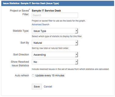

Now that I re-read your question, you should be able to use the regular Jira gadget called Issue Statistics (just input your project or a filter with multiple projects) and pick Statistic Type: Issue Type, and it will show you a summary count.

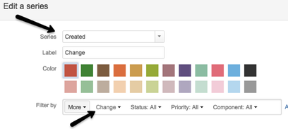

If you really would like to specifically use those 2 gadgets (the output looks different so that could be fun), here are some other ideas:
You can create a custom report called "Number of Requests per Type". Within that report, create a "Series" for each of your request types using Basic JQL in the "Filter by" section.
Once you've created this custom report, you can reference it in the gadget "Service Desk Report."
Alternatively, you can create a new filter for each request type that you have. For each new filter you create, just use the Basic JQL to select the Service Desk project(s) and Issue Type. Then input each of those filters into a new "Filter Counts" dashboard gadget.

Thanks for the suggestion however I think you might still get my question wrong. I am looking for request type filter and not issue type. I have no issue running a issue type report. But not "request type". As far as I understand, both are different thing.  The request type are not available as part of the statistic type selection.

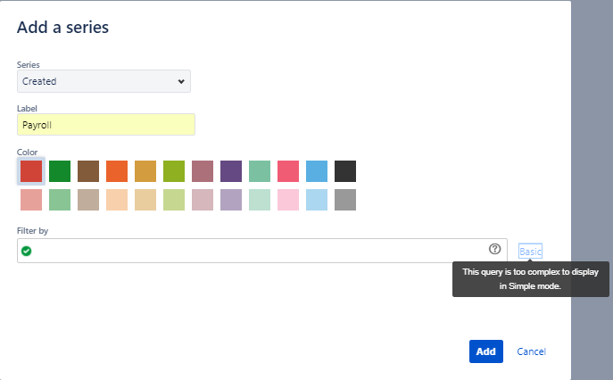

Also, wonder why my series version looks so different from yours? Could you please advise? Thanks

Your Series screen will not let you click on "Basic to switch to "Basic"? If that's the case, what happens when you click on "Basic"? It looks like you are currently in Advanced mode (typing out your filter). The "Basic" link is just a toggle more or less.
You're right- I defaulted to Issue Type filters in my answers. Sorry about that.

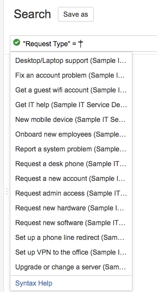

In Cloud, I'm not able to reproduce your problem with building the JQL filter (although this one you do need to do in Advanced since the "Request Type" field doesn't exist in Basic. Can you do a screenshot of what you have that is failing?
Here's what I have. The filter I'm building gives suggestions for Request Types (that is the cursor in between the two quotes):

Here's the warning message I got when try to switch to basic.
basic.pngBut the good news is, I manage to filter request type finally with your example syntax. Is the JQL syntax that caused me problem.
Thank you so much!

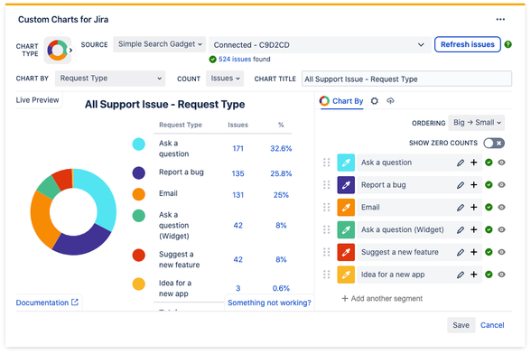

Tom Harris - Old Street
September 12, 2020
If you're looking for an easy solution to this problem our app Custom Charts for Jira allows you to select Request Type as a statistic. You can also select the colors, rename and group Request Types together directly in the chart editor, with zero coding required.
You can check the app out right now on our interactive app playground.
I hope that helps anyone who is also looking for an answer to this question 🙂
