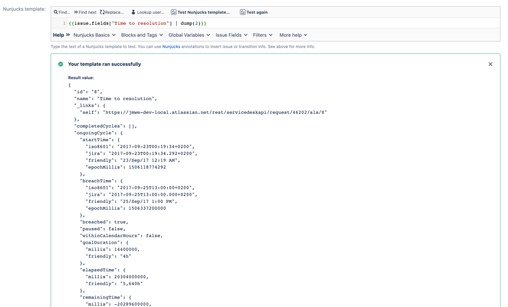

You can also do this easily in JMWE for Jira Cloud, using the Nunjucks Tester to see the value of the SLA field. For example:
Then you can use a Set Field Value or Set Field Value of Linked Issues post function to  copy some of this to a custom field. However, what you cannot do, for obvious reasons, is to copy the whole SLA field, as it would make no sense (the SLA field records what happens to an issue, so it's issue-specific).

Hi @JiraAdmin
the RemainingTime is available through this:
{{issue.fields["Time to Resolution"].ongoingCycle.remainingTime}}
But it's in milliseconds so you might want to transform it into some more readable form. Also, note that it will become instantly obsolete since the remaining time changes every millisecond...
Likewise, the breached time is available through:
{{issue.fields["Time to Resolution"].ongoingCycle.breachTime.friendly}}
